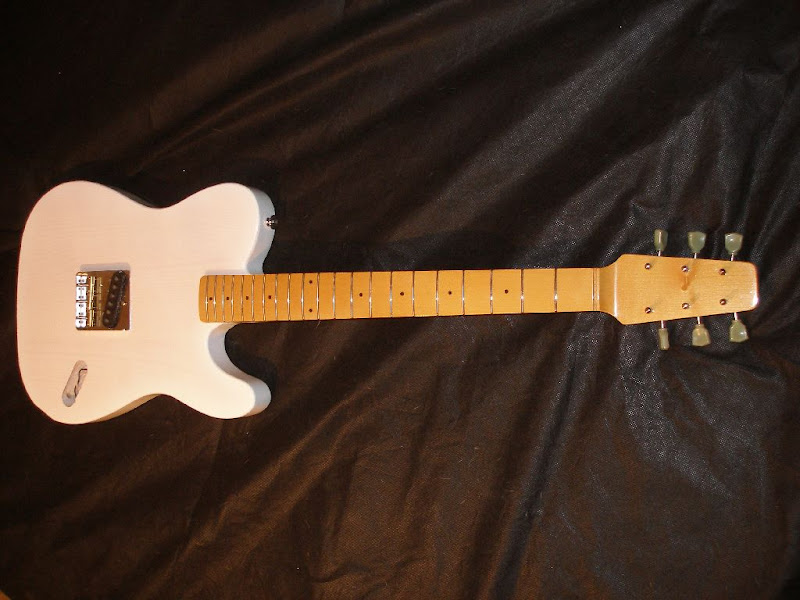

Pictures from finishing:
Yesterday I did spray Whiteburst on first coat white lacquer, today few coats clear nitro
one layer Yellowish lacquer on the neck looks more vintage

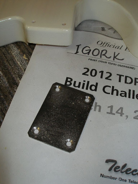

Making of the neck plate

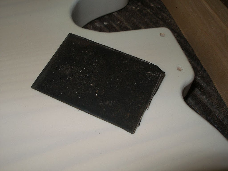

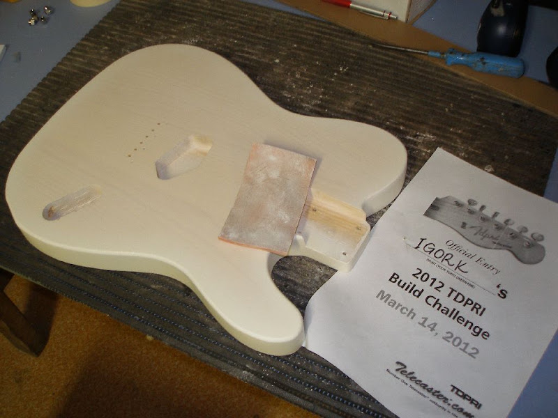

Holes for string ferrules
Dry sanding with P600
Vet sanding
Body after polishing
