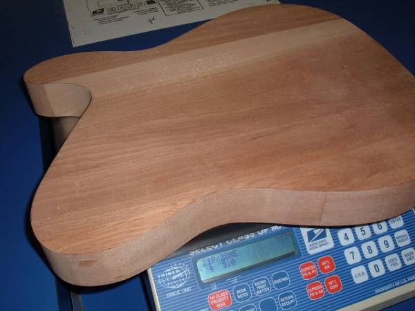

4lbs 5 oz. too heavy.

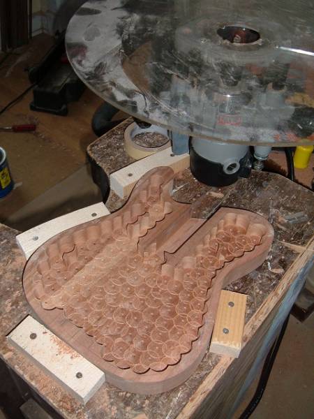

put the neck on the centerline, screw down boards and hog.

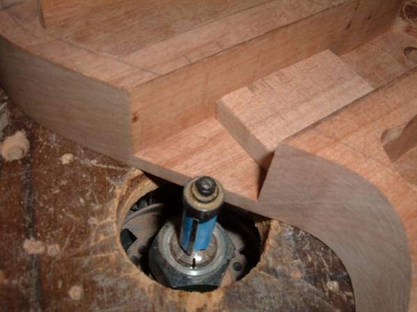

removing the face of the neck pocket. the piece of wood on the inside is a cut-off from the neck tenon. it's really tight against the sidewalls. forms the backside of the template.
hogged. face is taken down to 3/16"s. sidewalls are 3/8". no template. face-plate of doom on the PC690.

Ah yes - I remember that faceplate from last year:
That looks extremely useful.

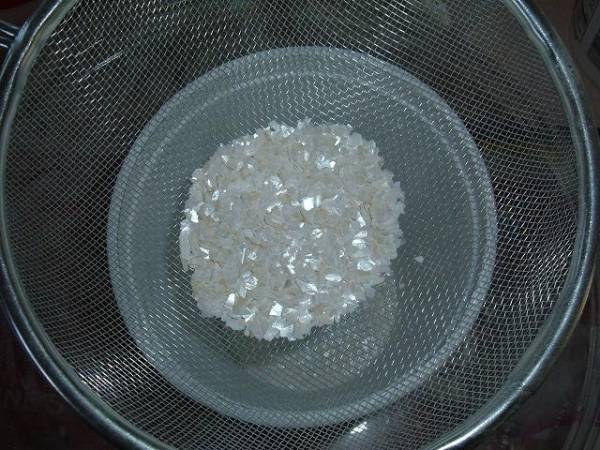

sorted by color. i just used the white sections though.
$4 mortor and pestal. just a swish around once or twice. the shell pieces are pretty flakey and i don't want to break them up too much.
i re-crushed anything that wouldn't fit through the big shifter.
the little shifter separates the powder and smallest flakes so that i'm left with a fairly uniform size.
look at how clean it is! i guess i've put a few miles on it.
lately i've been noticing how effectively it contains the dust in the chambers. i should cut a hole in it and mount a small vacuum hose to it. someday.
