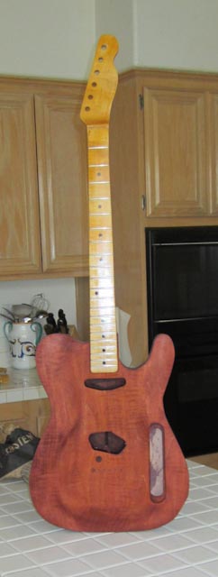

finishing the neck
I sanded the neck using 150, 220, 320 and 400 grit papers then cleaned it with naphta
I sprayed a sanding sealer, an amber toner, and 4 clear gloss lacquer passes - all Mohawk rattle can products
I may have gone overboard with the amber toner and it may be a little bit too dark, let's see tomorrow with better light
I will start finishing the body tomorrow

next I fine sanded the body
since the neck came out as antique amber, I decided against using amber for the body and went with the merlot water based dye
I let it dry, and here was the result
I really didn't like it, so this morning I sanded the top almost fully, which was also a good thing since the fibers were raised by the original dye application. I also read from a finishing book that if you use this technique it is recommended that you first apply distilled water and sand again with the same grit to level the fibers.
Anyway, I went for something warmer to attempt to match better the neck, and applied amber dye and a little bit of the merlot dye on top
I like this much better
I am waiting for this to dry to start with the lacquer routine

started applying the lacquer
left the sides and the back with a lighter merlot
now the waiting starts, i am going to start on setting up the electronics
