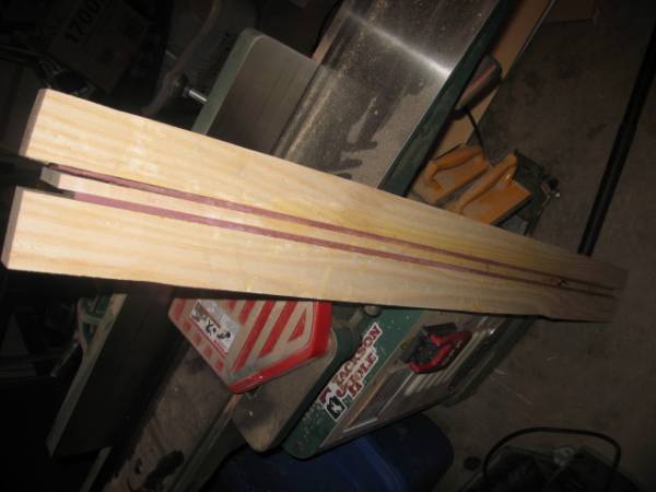

gluing the neck blank
First things first, I needed to use some boards to make a different board to make a neck out of. So I took some of the ash from the previous pic and cut it into strips and jointed the sides so that they were nice and straight.
I then placed the 3/8" maple strip in the center and the two 1/4" purpleheart strips beside it (these were leftover pieces from the last bass I built last year, that's why they were already milled and ready to use). Once I had them in place, I took the ash and clamped (dry, no glue yet) it to the side of the others.
I then checked to see if my joints were good by holding the whole thing up to the light. If there is light coming through the joint, it needs more work. Fortunately, it all looked good, so I spread som glue and clamped the whole thing up nice and tight.
Tomorrow, I'll remove the clamps and square it all up. Then it will be time for the scarf joint for the headstock.
See you then.

Took the clamps off of the neck blank this morning and it looks pretty good. Nice and straight and should mill down to just about the right dimensions in the end.
I'll get pictures tonight along with making the piece for the headstock. Things are moving right along.

Got some more time in the garage tonight and got a bit done. I took the neck blank that was in the clamps...out.
And I ended up with this.
After a few passes through the planer...I had this.
It turned out just right. Not too thin, but not too thick at just under 7/8".
