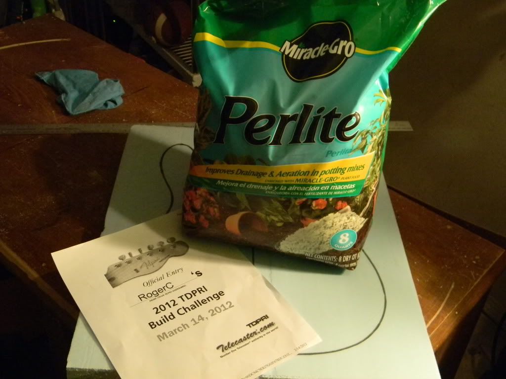

We have liftoff!
The group shot. We have tempered masonite, 2" extruded styrofoam, mahogany, walnut, misc dowel rods, and oh yeah a 94lb bag of portland cement
Oh, and my secret weapon for mixing up a light weight batch
The theory is that the lighter perlite will lower the density of the mix, thereby causing it be lighter. It sounds good anyway

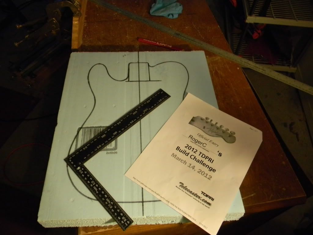

The styrofoam will be my outside form. First thing I had to do was get it to a manageable size
Next, I marked its center line, laid out my template and traced
I then had to mark out my neck pocket area
You'll notice that it's upside down. I debated on this for a while about which way to make my form-- right side up or upside down. There were advantages and drawbacks to both, but I finally decided that there were more advantages to pouring the mold upside down.

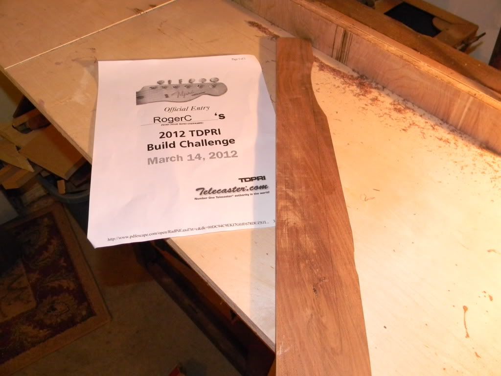

Here's my mahogany neck stock with my template on to mark for rough length
Next was trimming to rough length. don't have to be too precise at this point
Since the neck stock was too narrow, I had to glue on an ear. First I had to prep the top edge

Then I turned my attention to a piece of scrap walnut for a fretboard. I picked out the thickest one and started to trim it down to a manageable shape
The only thing I'm a little worried about is the small knot area. It looks like it's going to fall around the 16th fret or so, and mainly be in line with a fret slot. I'll just have to see how it works out. I can always cut a piece from my larger stash if I need to.
