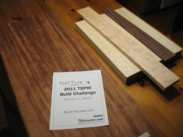

build start proof
That's some Home Despot birdseye maple, a piece of 1/4" rosewood,
a two-piece poplar blank, and two pieces of eucalyptus veneer.
You can smell it's eucalyptus!
Now I'll take out of the oven one that I prepared earlier...
Pity to cover the poplar with veneer as it's a nice piece with no
green streaks.
Anyway, the plan is for a double-bound body with bookmatched
veneer on the front and back. Cream binding. The veneer is
gorgeous and will get better when finished.
Chrome hardware; standard tele pickup configuration. What I'm
attempting is a classic, beautiful and great-sounding tele for
under $250.
My current price list shows a total of $219, not including shipping.
But I'm getting all parts from just a couple of vendors, so even
with shipping I should be well below $250.
flatfive is offline
