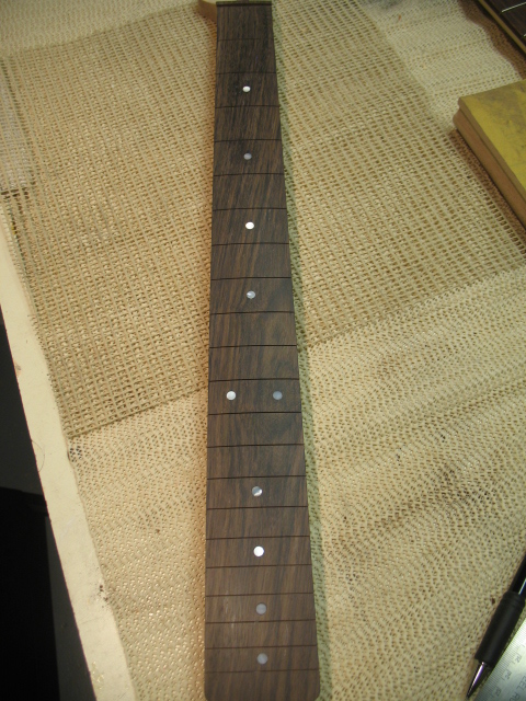

Today I sanded the neck to clean up the epoxy from
yesterday. Went from 320 to 600. The problem dots
don't look too terribly misaligned anymore.
All the dots:

Your dots look fine dude... good save... anybody can screw up... not everyone can recover.

Your neck looks great!!

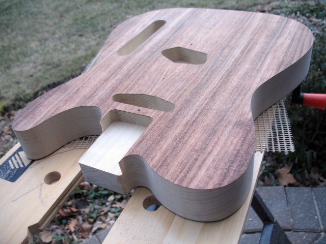

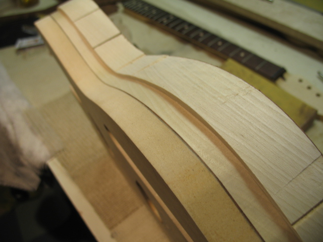

Body's got to be ready to finish next weekend, so I'm
focusing on that for a couple of days.

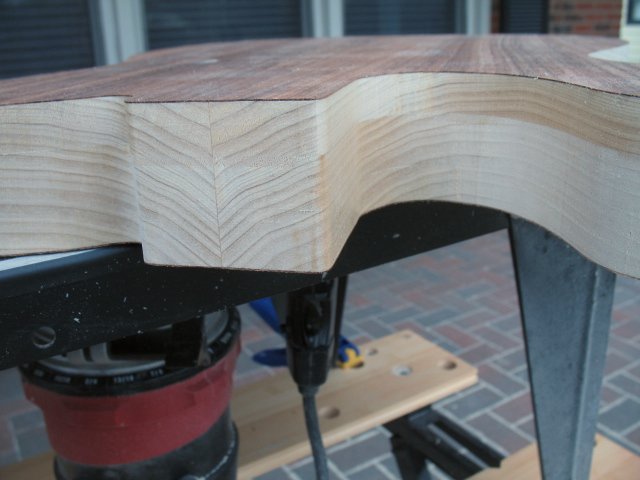

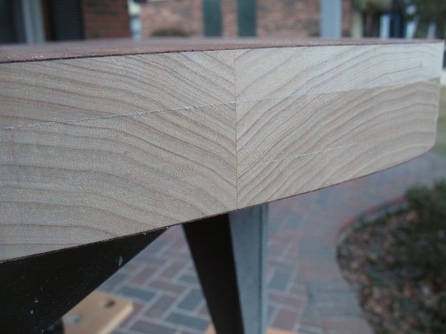

First I finished routing around the sides. I did it in three
passes.
That's a Craftsman router table that a friend sold me, with router,
for almost nothing. I think I paid a fair price for it; it's terrible.
But I like my Craftsman drill press.
Routing took forever, because I really wanted to avoid small
tear outs near the horns and at the heel of the body.
It turned out pretty good.
Then machine sanded with the ROSS, so now just a little
bit of hand-sanding is needed.

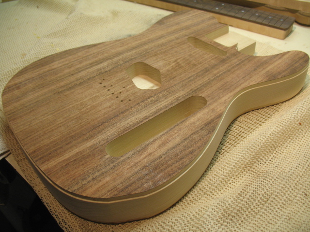

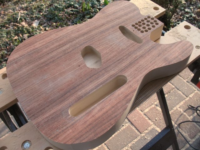

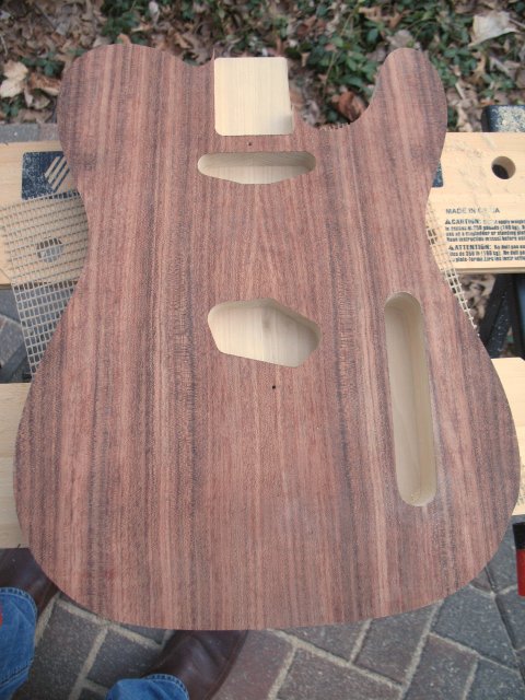

Got ready for the cavity routing. Screwed the template to
the body, penciled the cavity locations, then drilled. I used
to use a forstner bit for this and now just use a regular bit;
it's a lot faster.
Cavities routed.

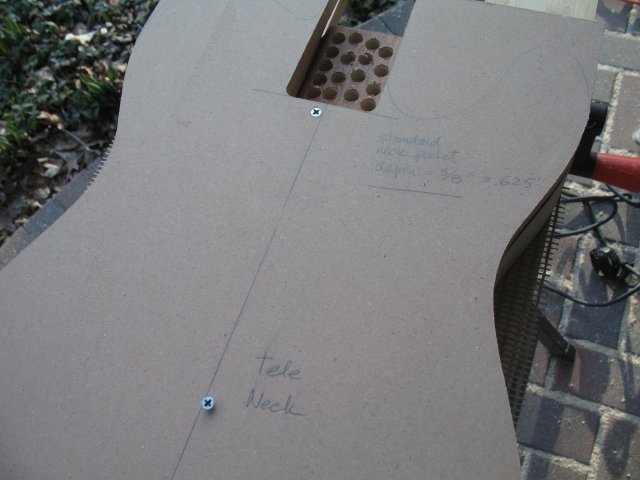

Found my old neck pocket template and screwed it on. It sure
is nice having those templates around!
Neck pocket's the standard 5/8" deep.
The template might look funny -- it's a 1/2" template
extended with 1/4" MDF. With a usual 1" long trim bit you can't
route 5/8" deep with a 1/2" thick template. You can guess how
I know that.
All internal routing done.

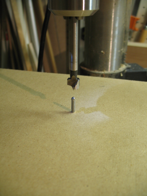

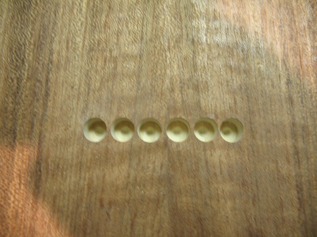

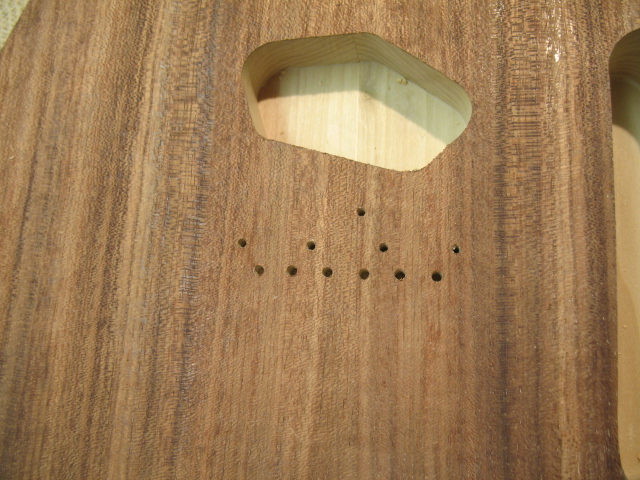

First job today was drilling the bridge and string-through holes.
To drill accurately I like to drill using a paper drawing.
Now that I know about the program 'briss' I can easily
crop the bridge section of Terry Down's drawing and use
it for drilling the bridge holes.
The drawing was double-sided taped to the body.
I use the standard "alignment pin" method for the string-through
holes. Here's the standard shot:
Turned out pretty good, but the right two holes are a little
too close together.

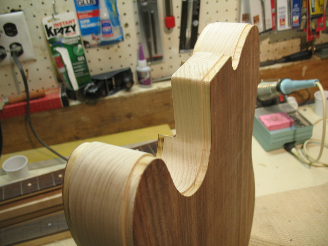

bit designed just for this. I'll using .060 x .25
cream binding.
Binding on the front and back!

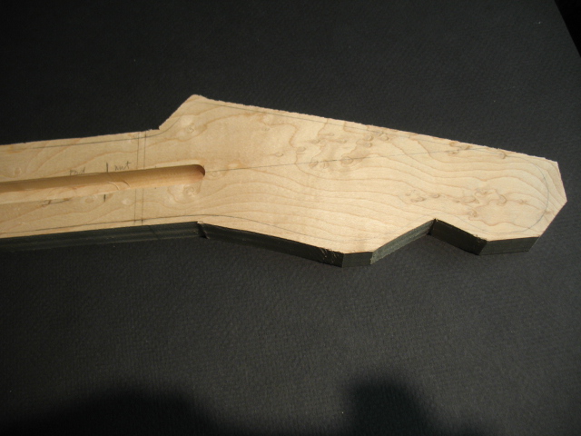

Routed the truss rod channel on the "real" neck, and jig sawed
the outline. Too bad a lot of the birds eye figuring got sawed
off.

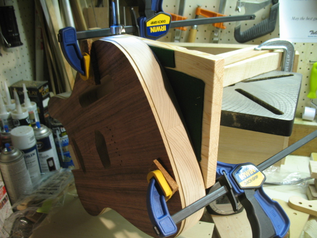

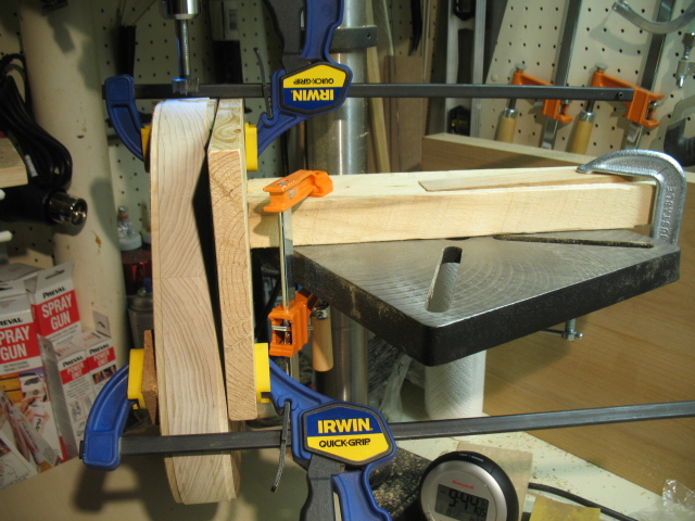

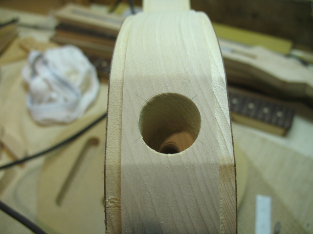

Last step of the day was the output jack hole. I have a funky
little jig for this job.
The picture's busy so it's a little hard to see what's going on.
The jig's nothing more than a 2x4 screwed to a piece 1" pine,
with some felt to protect the body.
It didn't work very well! I used a 7/8" forstner bit and it
pushed the whole body down a bit, putting the hole in the
wrong spot.
I'm a bit annoyed because this is my fourth
body build and I should have this step together by now.
Good news is that I should be able to spray lacquer on
