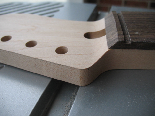

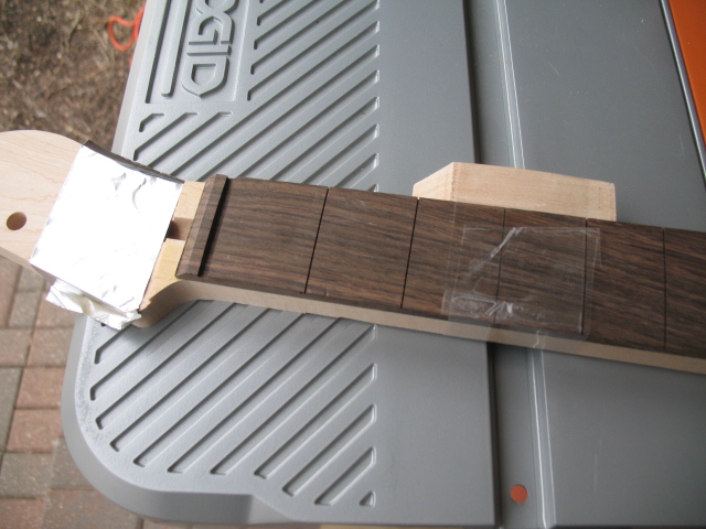

I was looking forward to sanding the headstock transition,
as it always looks like fun in other threads.
Before sanding the transition:
The aluminum tape is an "innovation" of mine to prevent
sanding mistakes from wrecking the headstock. I saw that
someone else (sorry, I don't remember who) used metal
sheet on the headstock for this. The tape didn't work --
it ripped the second the sanding sleeve hit it.
The block taped to the side of the neck was intended to keep the
neck level when it's supported by the block and the headstock.
But I don't think it helped much.
After sanding with the ROSS and just a few seconds of
hand sanding to clean up:
You can see the slight problem where the corner
of the fingerboard meets the headstock.
The next thing was to remove excess fingerboard from the sides
of the neck. The router worked fine on this step -- I'd been
worried about tear out since rosewood is brittle. I had to
remember not to do this step with the neck face down on the
routing table -- there's a radius on the fingerboard!
No good pic showing the routed fingerboard -- but here's
a before and after of the headstock:

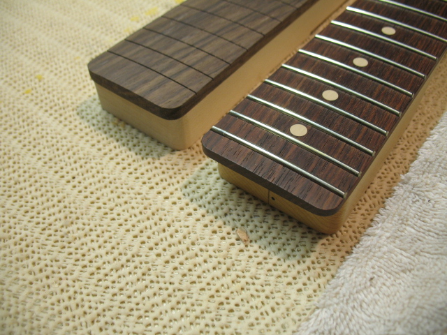

Last little job was to use the ROSS to sand excess fingerboard
from the neck heel. I was halfway through this, thinking how
easy it was to sand away the rosewood, and how the rosewood
smells likes cinnamon, when I realized that tele necks often
have fingerboard overhang on the heel.
Here's a shot of my neck (left) and a Warmoth neck, lined right
up with each other:
Hmm, that Warmoth neck has 22 frets -- I guess that's the
reason for the overhang? So I can go ahead and sand off
all the overhang on my neck?
Yup . Really sweet looking neck

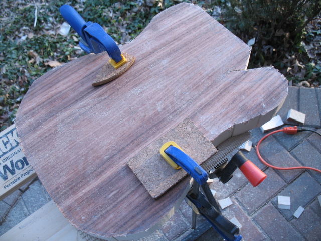

Today was not a high point for me in this challenge.
Things started off great -- beautiful late afternoon, in the
upper 50's and sunny.
I found my 3/4" MDF tele template, lined up the center
to the line where the veneer pieces meet on the blank,
screwed the template to the blank, drew the outline
in pencil, unscrewed the template, and went out to
jigsaw the outline.
I screw the template in before drawing the outline to
make sure there's no difference between the penciled
outline and the final template position.
Anyway, started with the jigsaw.
It took almost an hour to cut the outline. The jigsaw was soooo
slow through the poplar, especially in the direction of the grain.
I also had to worry about chipping of veneer, so I didn't get too
close to the edge. Besides, the blade wanders a lot around
turns.

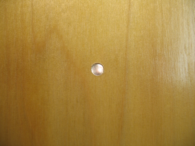

After sawing I started sanding on the ROSS. Here's the current
state -- still lots of sanding to go.
The scrap on top is a piece that was sawn off. I wiped on
a couple of coats of shellac to see what the finished color of
the eucalyptus veneer will be.
I think it will be pretty. The bit of curly figuring in the veneer
stood out after the shellac.

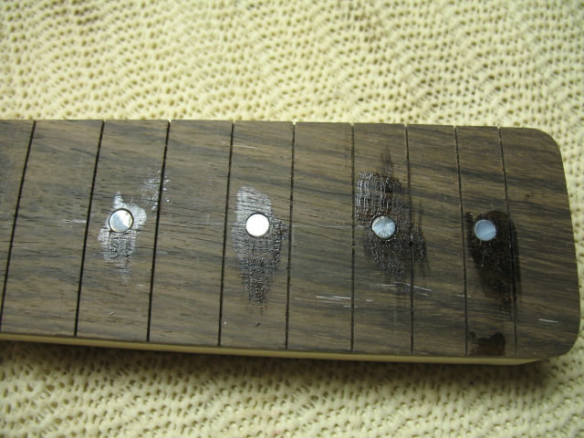

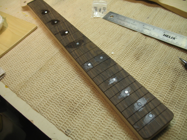

Next came the position dots on the neck. I got 5mm mother of
pearl dots off eBay. I didn't think too much about the size --
they're smaller than I like and I wish I had a 5mm brad point
bit.
I got a 13/64" bit and tested it on scrap.
The hole could be just a hair smaller.
The hole drilling seemed to go okay but when I inspected I
found that two holes near the neck heel were noticeably
out of line Darn, first visible screw up.
I decided I had to try some sort of fix, so I re-drilled the holes
slightly to correct, then added rosewood dust I've collected
with epoxy, and glued the dots in.
I'm not sure I corrected the problem area very well. Here it is:
The middle two dots were the both off the center line of the
neck, in opposing directions. Guess we'll just have to see.

That eucalyptus looks amazing.
The body is going to be awesome.
