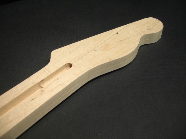

Until the days get longer I've got just a little slice of
time to work in every day.
Yesterday I managed to saw the neck outline with my
mighty Black & Decker jigsaw. Bandsaw, shmandsaw!
Forgot to take pics, but the saw did a good job.
Today I sanded close to the line.
"It starts to look like neck" (spoken in Russian accent).
Also managed to route the sides of the finger board to a
consistent width, and then to start radiusing it.
That's a StewMac 10" radius sanding block and some 80 grit
3M gold paper. (Like a good novelist I provide plenty of
concrete detail...) I actually sprayed a little adhesive to
the *back* of the block so it'd be easier to hold.
You will appreciate just how slowly I'm going when I point out
that this is still the practice neck!
ps my son says I should add (in Russian accent): "in Red
Russia, neck shapes you!"
flatfive is offline

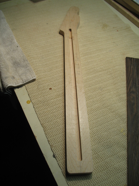

Routed the neck. Did it in two passes on my crummy little
sears routing table.
Didn't get any tear outs, but left the heel and the end of
the headstock for the Ridgid sander.
