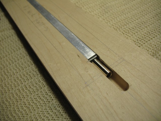

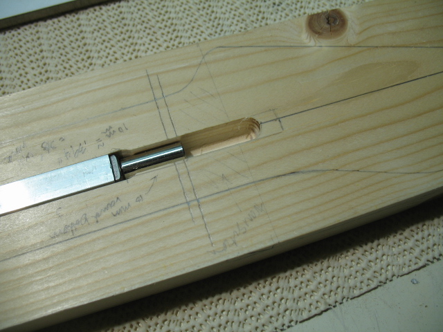

dipping my toes into the ocean of neck building
I did a couple of little tests on scrap this evening, despite
my debilitating cold
My main problem was trying to figure out the truss rod
adjustment cavity at the headstock. My two main
objectives: it's got to actually work, and it shouldn't look
wretched.
I think I finally figured out what I needed to do, but decided
to test things on a piece of 1x4 pine.
I clamped some MDF to my workbench, using the edge of the
MDF as a guide to route the truss rod slot. Here's the
routed pine:
You can see a snafu near the heel -- the MDF only guided the
router on one side, and I got sloppy.
It's a Martin-style truss rod sold by Stewmac.
I used a 7/16" straight bit for the main slot, plus a 3/8" rounded
bit for the part of the cavity that holds the adjustment nut, and
provides access for the allen wrench.
Here you can better see that the adjustment nut goes up to about
the nut, and the length of the access cavity.

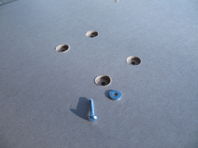

The fingerboard for the practice neck was more than
1/16" too thick, so I thinned it with a simple routing
jig.
The holes are there to hold the wood flat to the bottom
of the jig, even if the wood is bowed. Here's the view
from below:
The holes are deep enough to grab the wood with 1/8" of the
wood screw. But I wasn't too happy with how this worked out.
I used #6 screws. The holes were kind of big, and the rosewood
is so brittle that it wanted to splinter when I screwed it to the
jig base.
