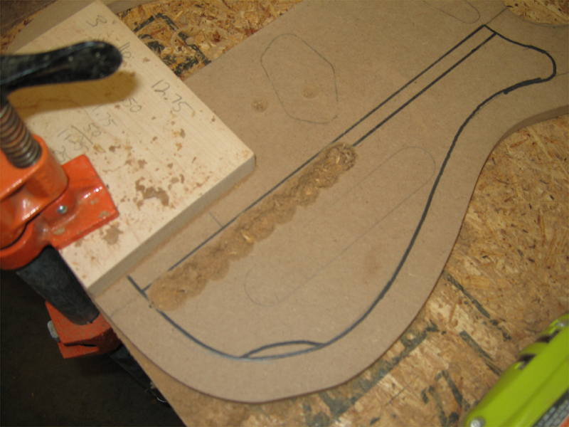

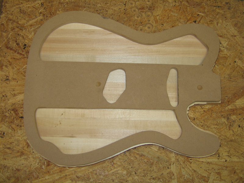

On a semi-hollow, do i need to cut a second template for the areas to be gutted out on the body? Or should i try it freehand?
alias23k is offline
Old March 19th, 2010, 07:07 AM   #20 (permalink)
Posts: 3,909

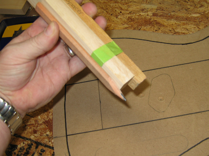

Thinlines are cool! If you have the time, it's worth making a template. Here's how I did mine.
My Thinline Build
I made this tracing tool and traced around a regular template. Then outlined it with a Sharpie.
Then I hogged it out with a large Forstner bit.
And cleaned it up with a rasp and sanding block.
Peace,
Mark
