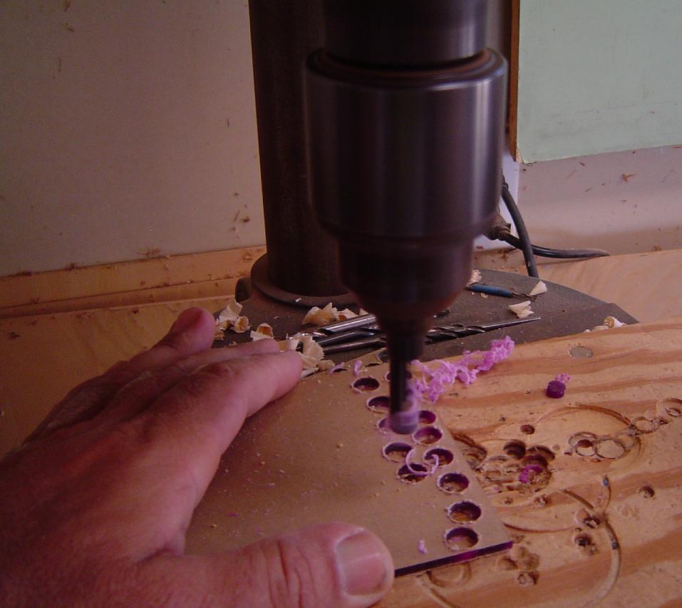

since my laser cutter is not set up yet i'll have to cut these inlays the old way with a dowel cutting bit.

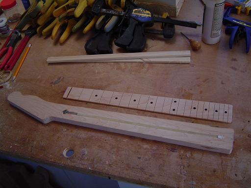

the inlays installed in the fingerboard, and truss rod installed in the neck.

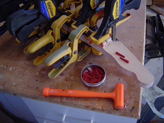

fingerboard glued on. tile setter's use these little wedges , and i like them for making sure the fretboard/neck blank joint is tight. plus glue doen't stick to them.

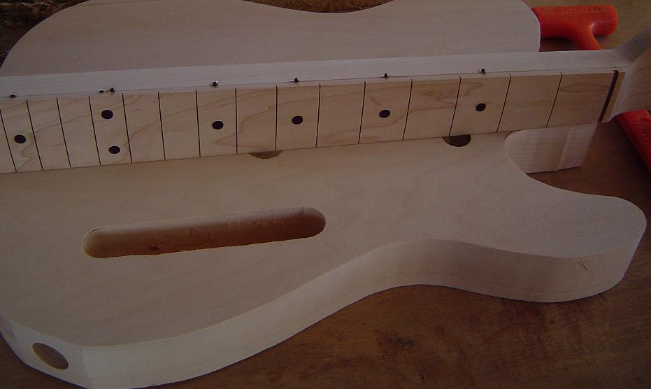

the neck with the side dots glued. also the roughed out body.
